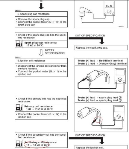

  14. Weak spark could be the plug.....but could also be the coil or HT lead/plug cap......Are you sure the plug isn't whiskered?......ie, doesn't have a piece of carbon bridging the spark gap? If you have compression and fuel getting into the combustion chamber then it must be the spark that's not strong enough......so maybe check the coil out....... I posted this for someone having trouble with a Fazer 600.....but I think the reading on most bikes would be very similar.....
