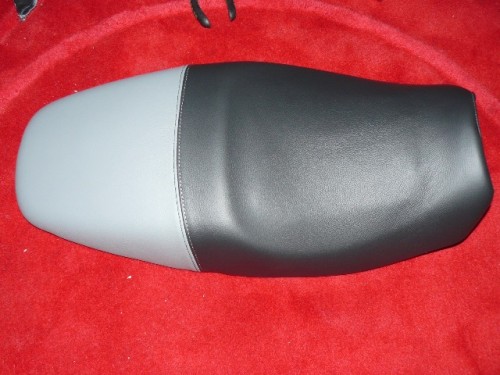

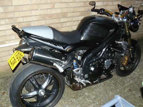

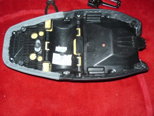

    Seat recover
    Fitted Gel pad and seat cover this afternoon......a GOOD staple gun is the key......oh, and plenty of patience.......
