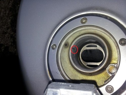

  4. looking at the pic what's the bit i have circled red? could that lead to the breather hole??

  6. its hard to see from the pic where the tank actually seals that hole could be inside the seal which allows the air in get a thin bit of wire down it

  18. Never known them to be on the air box No it won't always keep running if the carbs are dry they need to fill up with fuel first with the choke on it will choke the air supply and it will run on very little fuel Is there any pipes on the bottom of the tank? Sometimes they are on the bottom and run inside the tank to the top
  19. it does sound to me like a blocked breather it wont fire straight away as there is no fuel in the carbs so you have to drag that through first

  21. If it happens on the way home open the tank then close it it will take a few turns to start as the carbs will be dry but if you have to wait for 20 mins or so like last time I don't think that the breather is the problem

  23. That could just be the overflow you will be able to blow through it as it doesn't actually go in the tank Some breathers are in the centre through the key hole lift the cap and there might be a hole in the centre

  25. Yeah it causes a vacuum and stops fuel coming out
