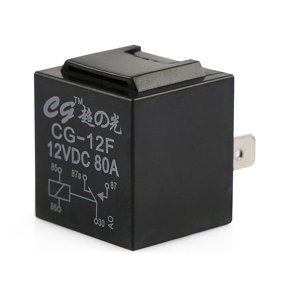

jedibiker Posted January 26, 2021 Posted January 26, 2021 8 minutes ago, husoi said: Thats a relay, if you have the heated grips they would have a switch already. Unless you want both. Yeah just want them to only power when ignition is on.. Not sure if they have a slight drain too.. thanks Quote
husoi Posted January 26, 2021 Author Posted January 26, 2021 Just now, jedibiker said: Yeah just want them to only power when ignition is on.. Not sure if they have a slight drain too.. thanks The relay will only become active when the power is on. the 2 contacts that connect to the coil will be one to (-) ground the other to the ignition (85). the other 3 are 1 to battery (30), 1 to the device you want to connect (87) and the other will be left disconnected (87a). Difference between 87a and 87 is that one is open contact at rest and the other is closed at rest. You want to connect to the one open at rest. I suggest the waterproof version instead a normal one for obvious reasons. Quote
jedibiker Posted January 26, 2021 Posted January 26, 2021 11 minutes ago, husoi said: The relay will only become active when the power is on. the 2 contacts that connect to the coil will be one to (-) ground the other to the ignition (85). the other 3 are 1 to battery (30), 1 to the device you want to connect (87) and the other will be left disconnected (87a). Difference between 87a and 87 is that one is open contact at rest and the other is closed at rest. You want to connect to the one open at rest. I suggest the waterproof version instead a normal one for obvious reasons. Great, so the earth cable from the grips will just stay on the battery or can be attached to frame etc? thankyou Quote
husoi Posted January 26, 2021 Author Posted January 26, 2021 Just now, jedibiker said: Great, so the earth cable from the grips will just stay on the battery or can be attached to frame etc? thankyou You're all mixed up. Earth cable from the grips just connects to the frame. The + cable goes to the battery (or relay - 87) 1 Quote
jedibiker Posted January 26, 2021 Posted January 26, 2021 3 minutes ago, husoi said: You're all mixed up. Earth cable from the grips just connects to the frame. The + cable goes to the battery (or relay - 87) Nope, I said to battery or frame so was half way there lol. The + part made sense though. Appreciate the input 1 Quote
